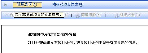

大侠们好,我把项目计划用project pro发布成功了,大在pwa里看到项目的名称,但是点击详细的任务看不到,是什么原因啊?传个截图如下

另外,发布时spooler报 系统错误0x80004005

1,出错的问题.
2,权限的问题.

Re:请教一个关于项目发布后的问题! [随风飘拂 修改于 2006/9/21]
You receive a "0x8C040028" or a "0x80004005" error message when you publish a project plan to the Microsoft Project Server Web site
View products that this article applies to.
Article ID : 328249
Last Review : July 27, 2006
Revision : 6.3
This article was previously published under Q328249
On This Page
SYMPTOMS
CAUSE
RESOLUTION
Method 1: Log on to a Windows Domain with the Novell Client
Method 2: Verify the ViewDrop Folder Permissions
MORE INFORMATION
SYMPTOMS
When you publish a project plan to the Microsoft Project Server Web site, you may receive the following error message with the Microsoft Project Server spooler:
1 new error(s) pending in the Microsoft Project Server Spooler.
Do you want to open the spooler window to view the error(s)
When you click Yes, or you double-click Spooler on the taskbar, you receive one of the following error messages in the Microsoft Project spooler dialog box:
Project Server Spooler Error (0x8C040028)
Project Server Spooler Error (0x80004005)
Additionally, you may receive the following error message when you quit Microsoft Project Professional:
An exception occurred in the Microsoft Project Server. Microsoft Project Server encountered a problem with this error code: 9100. Please contact your server administrator.
Back to the top
CAUSE
This problem may occur if one of the following conditions is true: • You log on to the network with the Novell Client and you do not specify Microsoft Windows NT credentials.
• You have restrictive permissions for the following Microsoft Project Server folder:
Drive:\Program Files\Microsoft Project Server\Bin\ViewDrop
Back to the top
RESOLUTION
To resolve this problem, use one of the following methods.
Back to the top
Note Use this method if the first condition that is listed in the "Cause" section is true.
When you log on to the network by using the Novell Client, you must specify the Microsoft Windows NT credentials to log on to the Windows NT domain. To do this, open the properties for the Novell Client, click Advanced, and then configure your credentials for the Windows NT domain.
Back to the top
Note Use this method if the second condition that is listed in the "Cause" section is true.
To verify the folder security permissions, follow these steps: 1. Log on to the server by using your domain user name and password.
Note You must have a local Administrator or Domain Administrator level user name and password to the reconfigure the folder security permissions.
2. Click Start, point to Programs, and then point to Accessories.
3. Click Windows Explorer, expand My Computer, and then click the drive letter that contains the ViewDrop folder.
Note The typical installation point is:
C:\Program Files\Microsoft Project Server\Bin\ViewDrop
4. Right-click the ViewDrop folder, and then click Properties.
5. Click the Security tab, and then view the list of names and groups that have permissions on the folder. Verify or add the following groups or user names with the appropriate permissions: • Administrators Full Control
• Authenticated Users Full Control
• Everyone with the following permissions: Modify, Ready & Execute, List Folder Contents, Read, and Write
• Internet Guest Account Full Control
• System Full Control
6. Click Apply, and then click OK.
For additional information about how to configure the security for files and folders on a Microsoft Windows 2000-based network (domain), click the following article number to view the article in the Microsoft Knowledge Base:
301195 http://support.microsoft.com/kb/301195/) How to configure security for files and folders on a network (domain) in Windows 2000
Back to the top
MORE INFORMATION
The ViewDrop folder is used to queue requests to publish project plans and other information to the database. There is a Windows NT service that reads from this queue and then processes the requests one at a time. This procedure optimizes the use of system resources throughout these sometimes long-running activities. The folder must have the security settings that permit the Microsoft Project Server Internet Server Application Programming Interface (ISAPI) DLL files, to write to the folder and the security settings that permit the Windows NT service to read from the folder.

谢谢随风飘拂,问题已经解决了,原因还是没有找到,估计适合用户及资源的匹配问题! 回头我再想想.解决方法:重装WSS还有就是资源重新加载了一遍.
