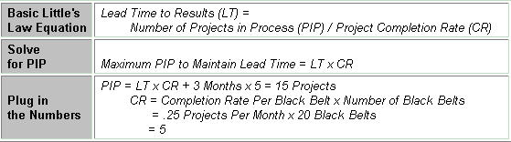

Little's Law applies here as well as anywhere. All that is needed is to substitute "projects in process" for "things in process." For example, assume that an organization has 20 Black Belts, and that the average time it takes them to complete a project is four months (for a completion rate of one-quarter projects/month/Black Belt). But now the company has decided that it wants to get projects completed in an average of three months. What is the maximum number of projects that should be "in process" at any one time? Apply Little's Law:
With 20 Black Belts and only 15 projects, that means some projects will have two Black Belts assigned (or that there will be five "floaters" who go wherever they are needed). Intuitively, this equation makes sense: by doubling up one-fourth of your resources (five Black Belts), the company saves one-fourth of the original lead time, or one month.

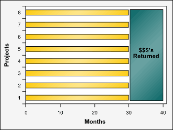

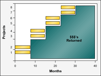

Another benefit of using a pull system to reduce the number of projects in process is that the organization starts to reap the rewards much sooner. To illustrate: In a traditional approach (Figure 1), all projects start at once. Each of four resources split their time evenly between two projects. In the pull approach (Figure 2), all resources are focused on the two highest priority projects. Once those are accomplished the resources move on to next highest priority projects, and so on. The result is more is accomplished sooner.
